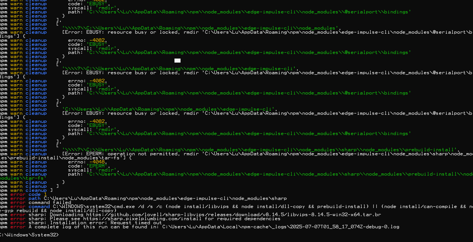

installation problem of edge impulse on Win11.
After I run the command
npm install -g edge-impulse-cli --force.
I got the following result.
![b6b89f7d6ac170422dbd029b7fd89d46|690x286(upload://cfvhBgWSHXaXhGOJpLbrWUVIlCz.png) ![269317027ba46e7fd7c51be77ad047e2|690x352](upload://tCwa2lZs3ggnZ2ktKwajQX6GUbi.png)

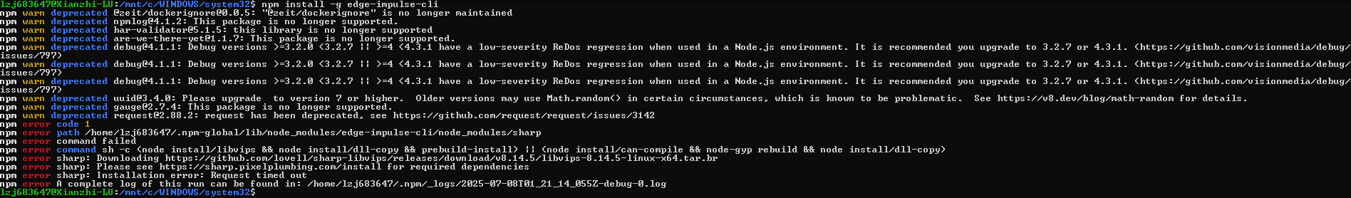

I tried WSL. It looks like ending with the same result. I am here in China. I have searched some guide on the internet and it seems that downloading from github with sharp is very slow in China even with a VPN. I suppose that is the main reason.
The output in WSL is as follow.
