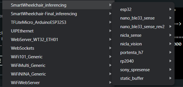

I am sorry but what is arduino sketch example?
if you refer to generated library, there’s no example arduino.
here I am facing the same problem with the topic maker guy
All of these in your screenshot are Arduino sketch examples. The one that I advised specifically was esp32->esp32_microphone.ino.
