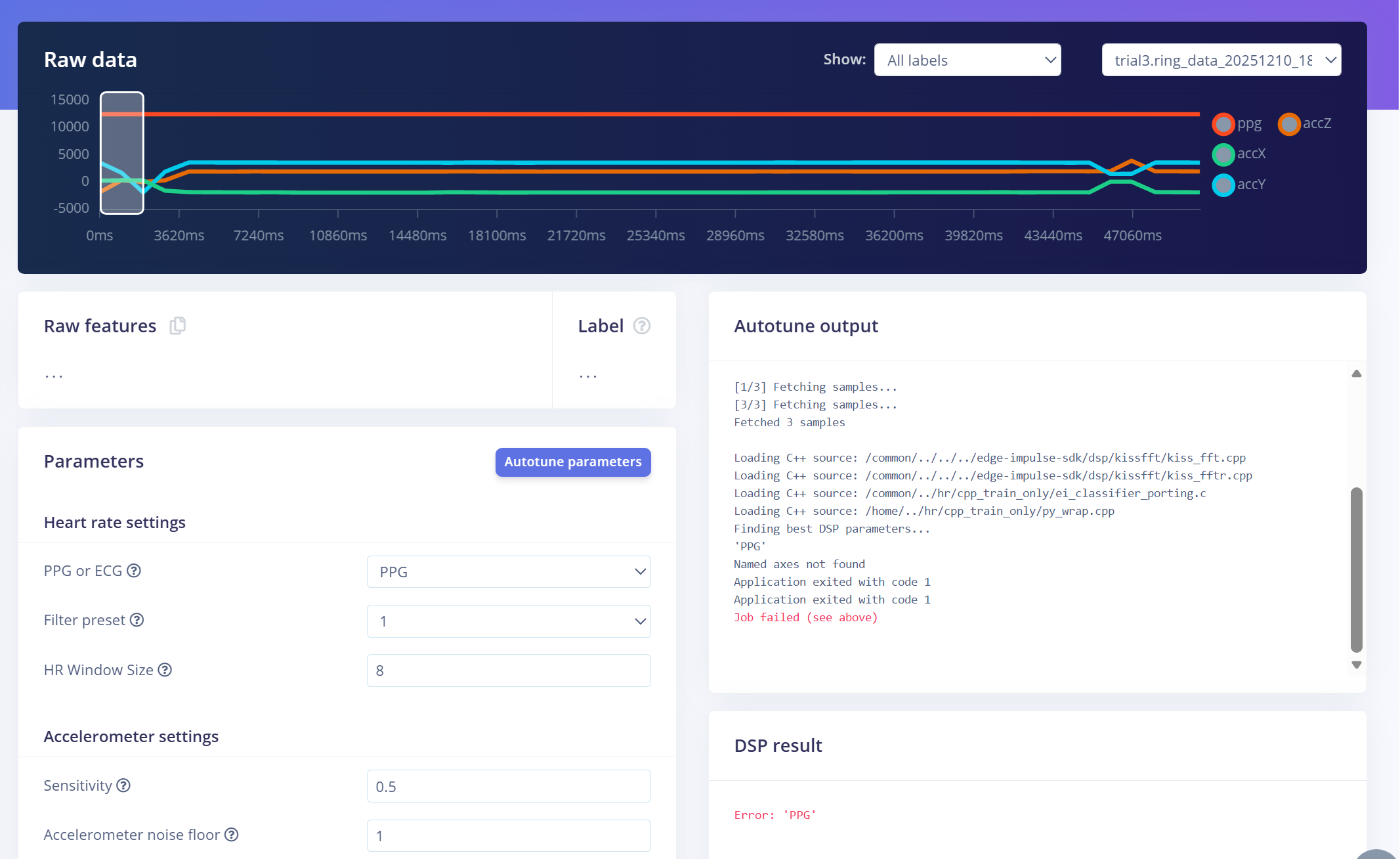

Hi, I followed the each steps of the guidance but it’s shown PPG axis is not here. But I have that in my dataset

It’s not readily apparent why this error is showing up but I’ve cloned your project to look further.
In the meantime, if you’re in a hurry and need a workaround, try deleting the DSP block and re adding it. Does it work with default settings? (ie w/o autotune)
Hi, I have fixed the issue in a branch. I will report back when it is available on prod. I’m not sure if we will push to prod before christmas at this point, so it will likely be early next week.
In the meantime the code should work with PPG alone (just leave the accel chans unassigned on the impulse design screen), if you just want to experiment in other ways. You can probably still extract meaningful HR w/o the accel based noise extraction (though of course when this is fixed, having that on is better)
