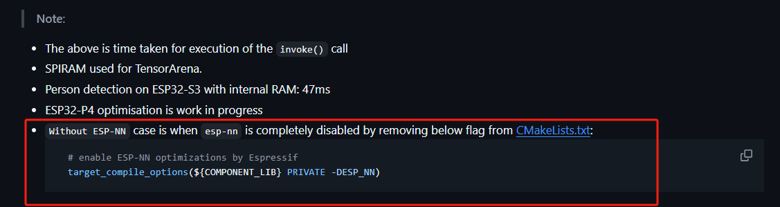

How to disable the ESP NN when using Arduino library deployment option? I am trying to compare the performance of ESP32-S3 with and without ESP-NN library

The README file for the ESP_NN library appears to mention how to disable it, and the official documentation provides some test results.
Judging by the given results, enabling acceleration can speed up inference by ten times or more; there is no reason not to use it.
