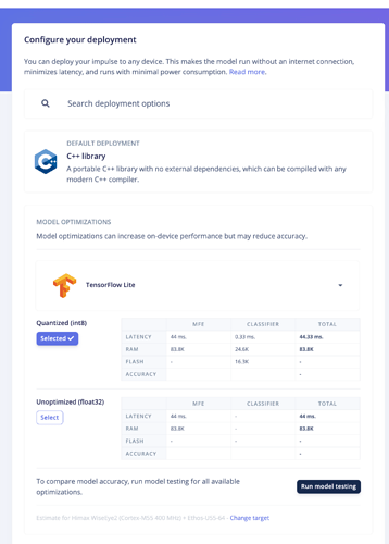

Welcome to the community @ben-wvs,
The model file will be in your project, when you export select TensorFlow lite
When you export your project first place the tflite-model directory when you select TensorFlow Lite as the export option instead of EON Compiler:
