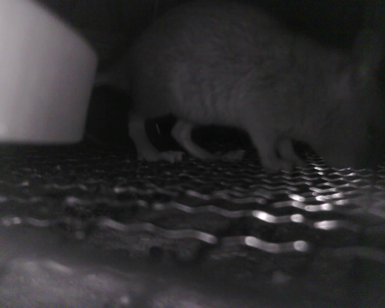

Do you think you can share any of your images to understand the contrast of them? The histogram equalization may be a pre-processing block? Did you try to use something like cv2.equalizeHist()?

LSCT260117-04_30_48
these are how the images look like in low light conditions
