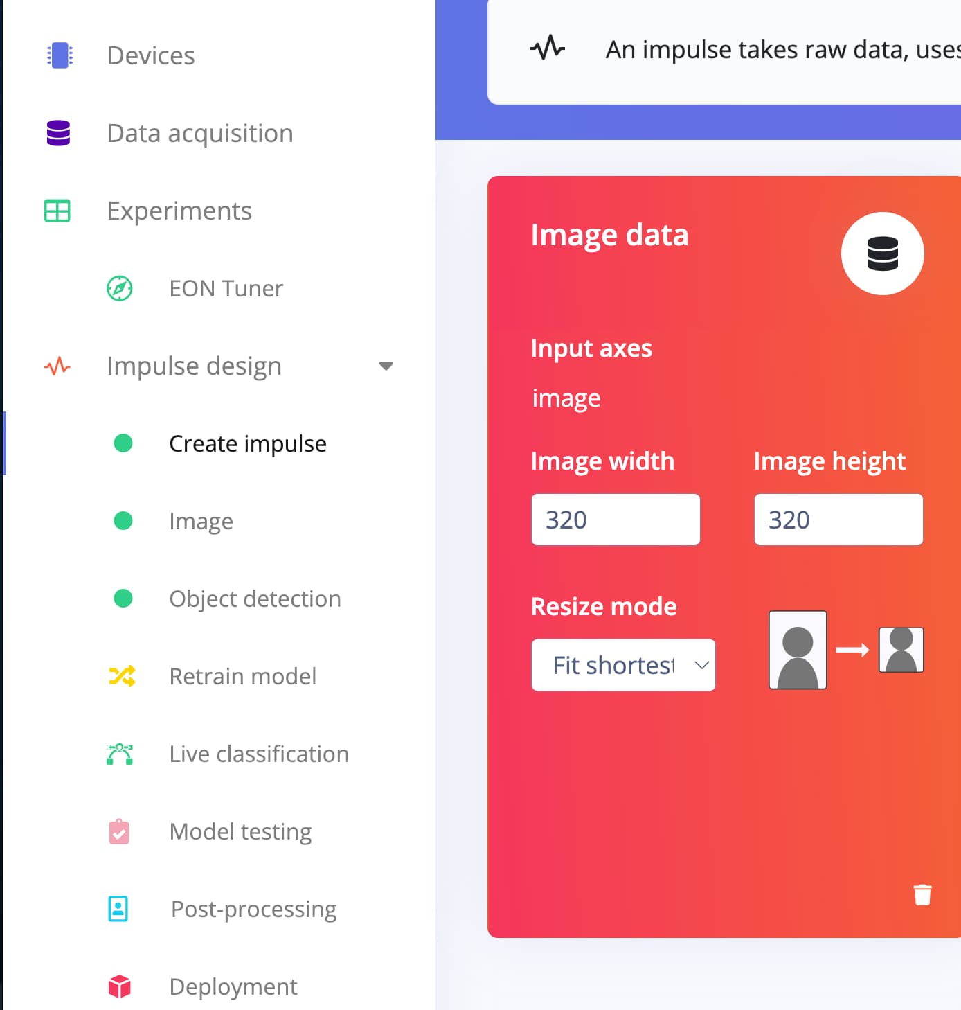

Maybe this is set too small like 64x64 or something:

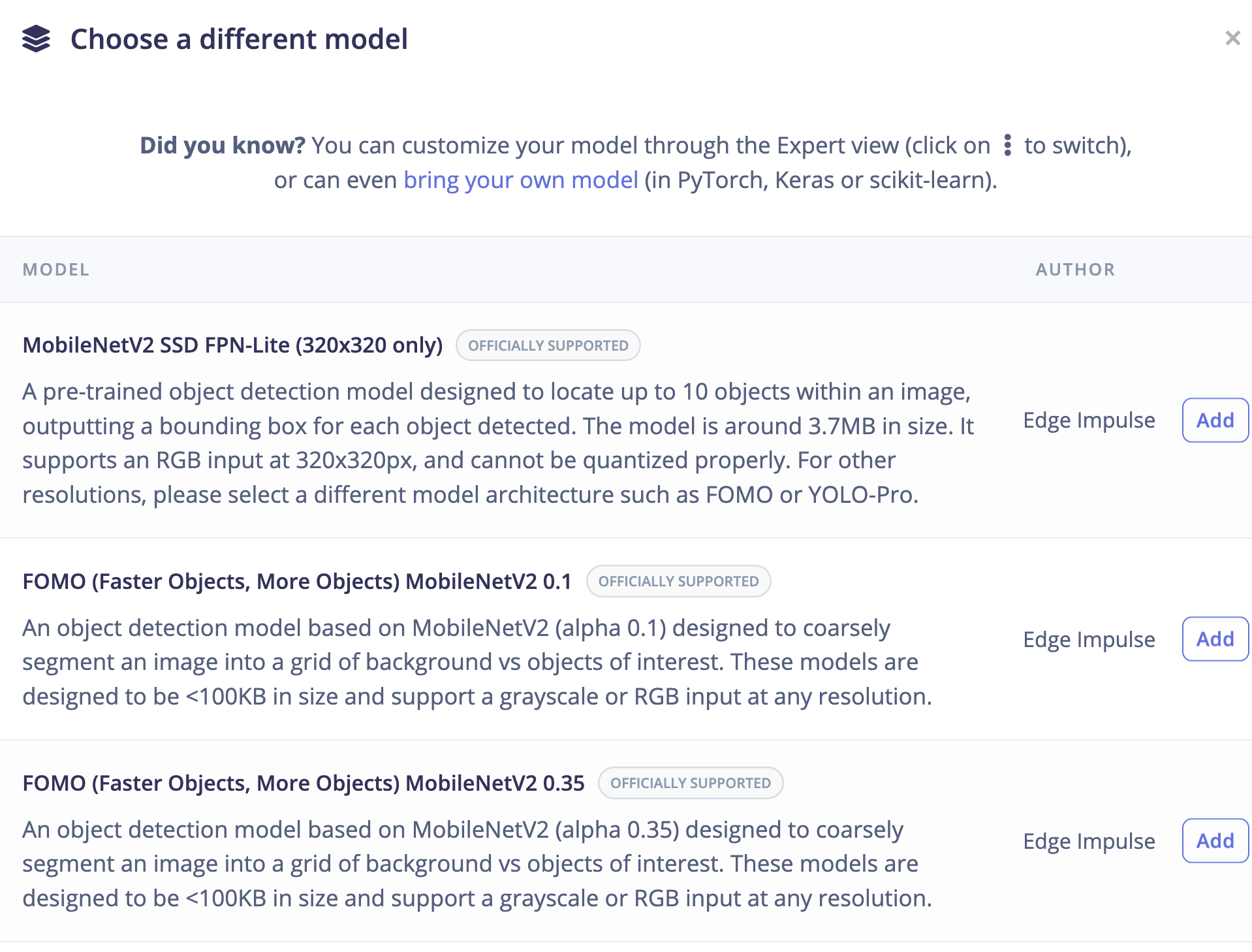

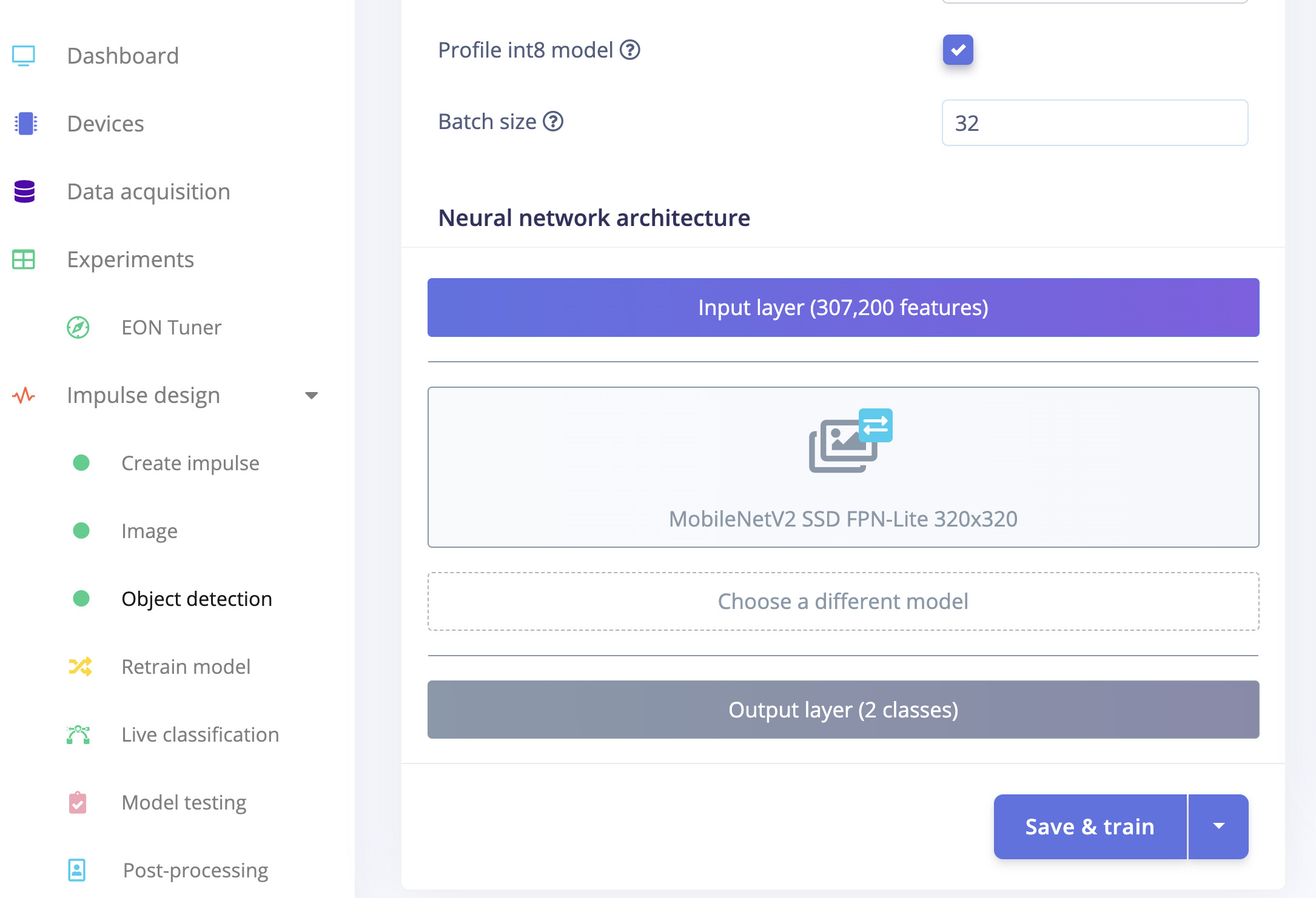

Trying a larger model would be my best guess at a config that may be missed:
When setting up the FOMO or Image Classification model, you can click " Choose a different model", then select larger variants like MobileNet etc:
