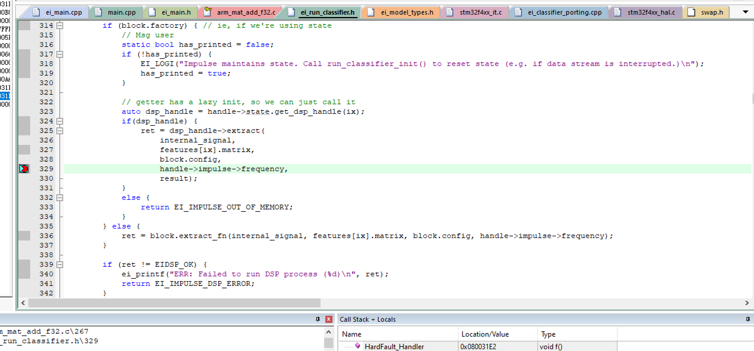

question 1:
When I start debug and execute the following function, it causes the STM32 to enter a HardFault infinite loop.
This function is in ei_run_classifier.h

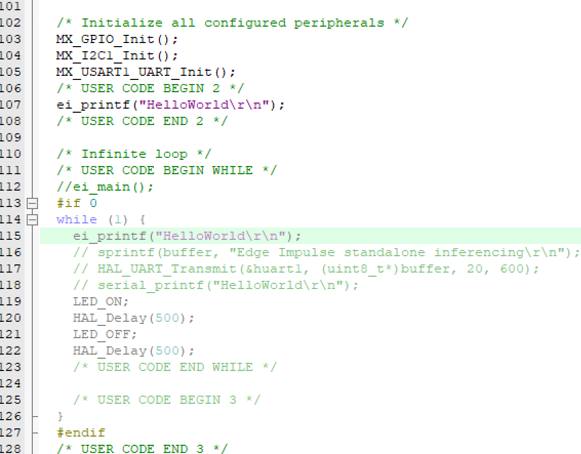

When I import the SDK, even the simplest program with serial output and LED blinking doesn’t produce any output after compilation and flashing; the MCU doesn’t work at all. It only works normally with serial output during debugging.
