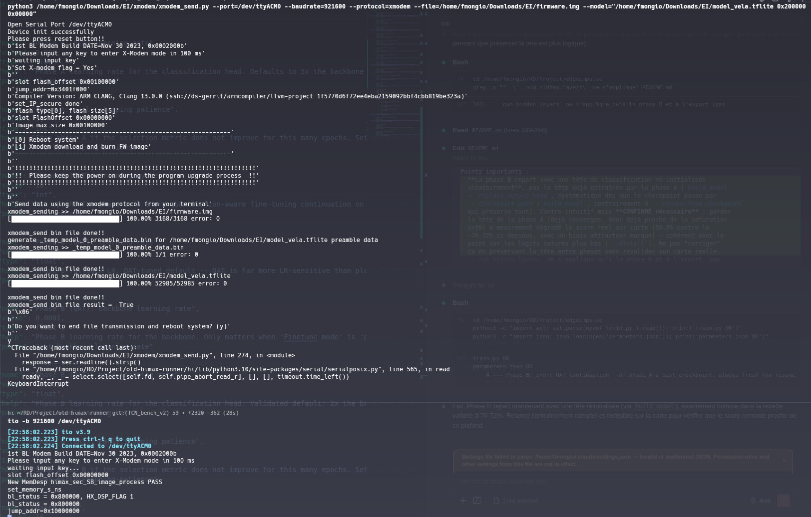

Hi @minimai-io,
The log output suggests that it’s stuck in the bootloader.
Can you share any logs/screenshots of when you flashed the firmware and model using the packaged flashing scripts. See the accompanying README.txt in the deployment zip.
Also can you try another project without a custom learn block but using one of our standard image classification projects/models. I’d like to elimante whether it’s the custom learn block or not.
Hi @marcpous & @rjames ,
Sure here is the screenshot
Screenshot from 2026-08-20 22-58-50

Hi @minimai-io,
Can you try flashing only the firmware.img and see if the application starts after rebooting?
python3 /home/fmonglo/Downloads/EI/xmodem/xmodem_send.py \
  --port=/dev/ttyACM0 \
  --baudrate=921600 \
  --protocol=xmodem \
  --file=/home/fmonglo/Downloads/EI/firmware.img
Also for the firmware that you tested and worked. Can you share the build logs and the flash and bootup logs? I’m currious about the addresses and sizes.

Hi @minimai-io
I will take over this support activity as I worked on the firmware that you can deploy from our Studio.
One think that I see on your screenshot is that you are opening the serial port using 921600 baudrate. Could you try 115200? The thing is, bootloader is using 921600 but then the firmware is switching back to 115200 (to be compatible with other supported boards), so:
tio -b 115200 /dev/ttyACM0
Also, could you share your project ID where we can reproduce the issue? Or share a Ethos library export for this board.
