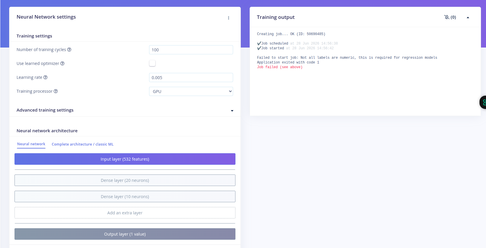

Failed to start job: Not all labels are numeric, this is required for regression models
I am unable to train a model on an 18-channel spectra data of the AS7265X sensor.

I could connect and stream the data; the attached image shows a screenshot. But for the past three days, I have been at the same spot; the training would fail and issue the following report show below.
Just trying out weird things, I attempted classification, and it went through but with 0% accuracy and 93 Loss. Yes, I wasn’t expecting anything.
The fail report:
" Failed to start job: Not all labels are numeric, this is required for regression models
Application exited with code 1
Job failed (see above).

OK, so a few things are going on here.
First, the job is failing to start because of what the error message says: Not all labels are numeric. Your impulse uses a regression block and a regression model expects to predict a continuous numerical value, e.g. 10, 22.4, 50.7, etc. Your labels, however, are not numeric, they are in the format of p75d25. So, if what you are trying to predict is the P+D ratio based on the sensor readings, what you want is a classification block in your impulse. That’s why classification works, because your data samples are set up with discrete labels. What do you want the model to predict?
The reason you are getting 0% accuracy for classification is likely because you have very limited data. You only have one sample for each label, each of only 6 seconds duration, split into 6 windows of 1 second each. And these get split between training and validation in the training loop (80/20), so you only have 4 or 5 windows of data for each label for training, which doesn’t give the model much info to learn from.
