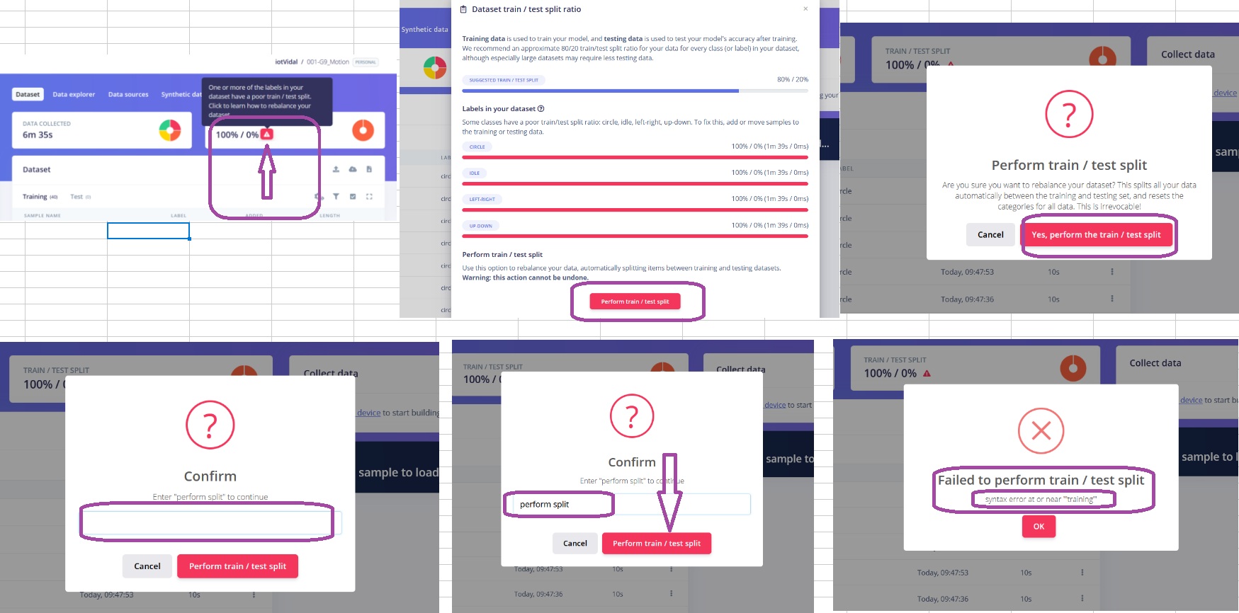

Hi
I started now in may 2025.
The split data is not running.
See pictures with the sequence
Vidal

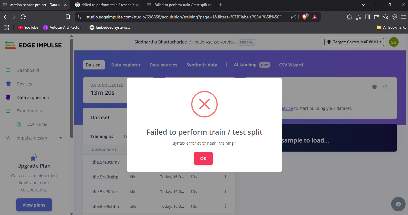

having the same issue here
Thanks for sharing and providing clear detail let me check with out studio team. We will capture this and investigate.
Fyi @04rlowe
Hi, facing the same issue, I can move them one-by-one
Hi @RadioActiveX1
Thanks for reporting, please create a new forum post for new issues so we don’t lose them. I’ve logged a git issue to our studio team for your issue. The issue is 13365 if you need to refer to it in future.
They will pick it up and fix once it gets validated and triaged.
