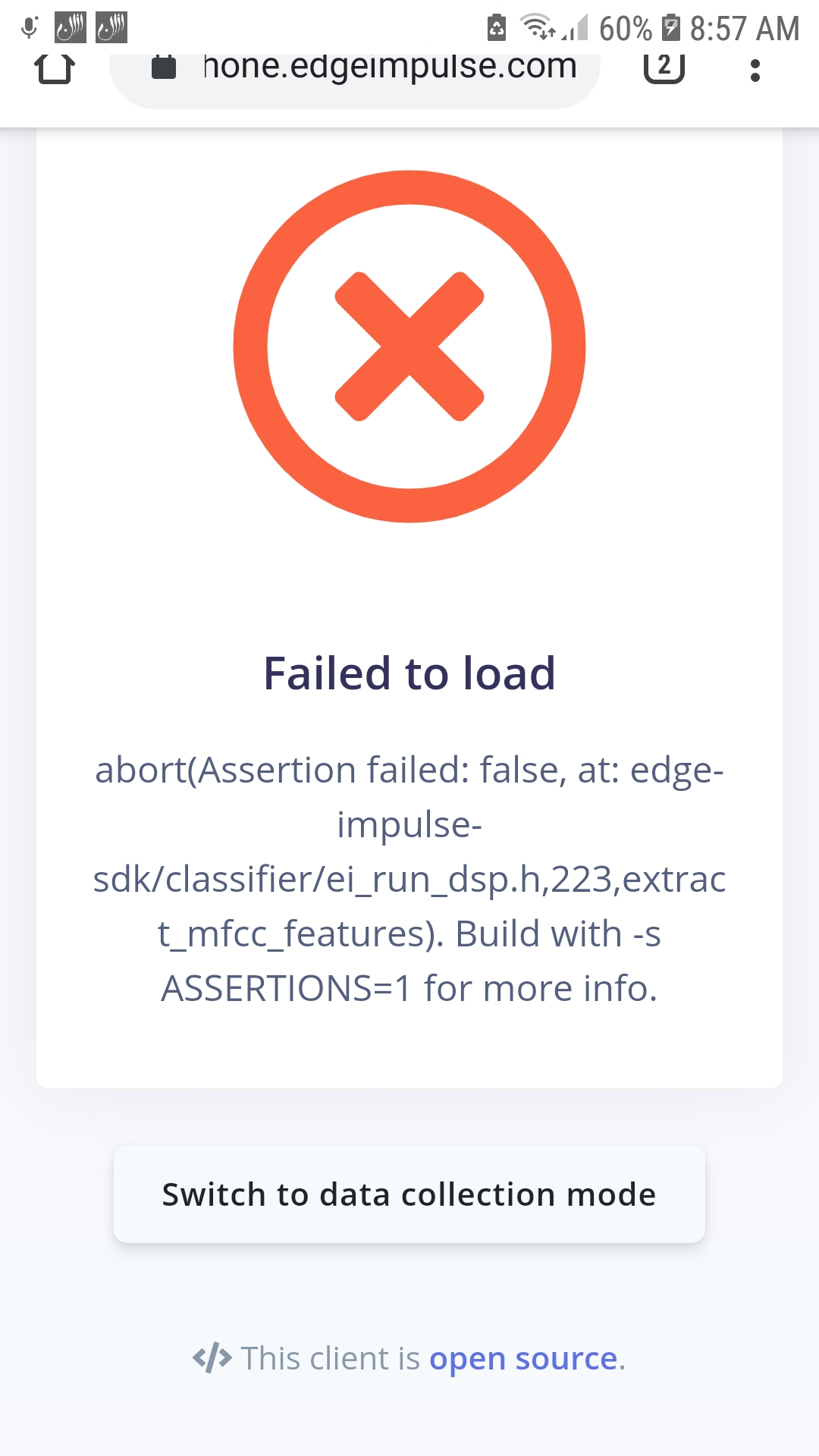

So, it does work nicely at the beginning! Then, it crashes later with the following error message:
I repeated the process 2 times, but once it reaches around 315 samples it crashes.
