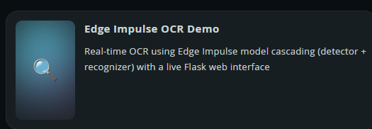

  • I clone the project to the Uno-Q as directed.
  • A new app appeared in the Uno-Q “My Apps” directory
  • I run the app.
It seems that your instructions are trying to manually setup a new project on the Uno-Q, where the simplified instructions are not.?
