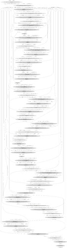

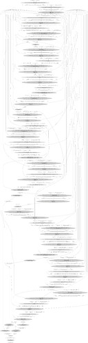

Could you share a screenshot of the input/output of the new graph you generated in Neuron please?

I extracted a subgraph at the output of “model/feature_extractor/AvgPool_2” (backbone output). My plan is to run the head on the CPU, feeding it with the features produced by Hailo.
