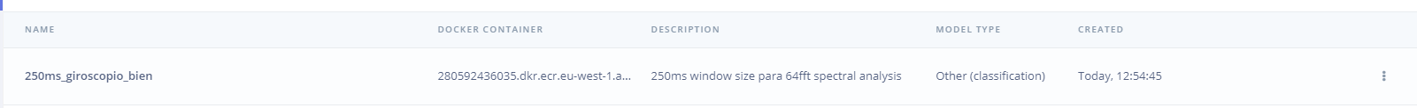

Here is my block in Machine Learning blocks page:
