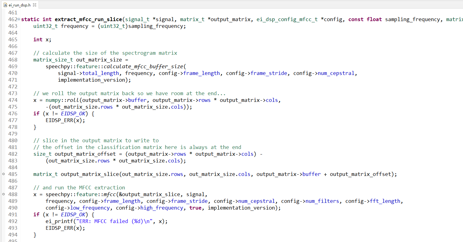

ERROR: MFCC failed (-1004)
ERROR: Failed to run DSP process (-1004)
ERROR: Failed to run classifier (-5)
The error seems to occur when the device performs feature extraction(mfcc) on the voice. I think the parameters of the voice processing should be the same when the two data sets are used separately, but obviously this is not correct. After changing to the second data set, which parameters should be modified by the dsp module to solve this problem?

I think the error code MFCC failed (-1004) is an “Out of dynamic memory error”.
Which board are you using?
Hi @sherry -1004 is actually EIDSP_MATRIX_SIZE_MISMATCH - so one of the buffers passed into the function is the wrong size. If you could also share how you’re calling the model that would help (in addition to the project ID).
