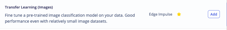

I’ve checked your project.
You are using the wrong learning block, try to use the Transfer learning (Images).
instead of the Akida one that is actually used.
let me know.
