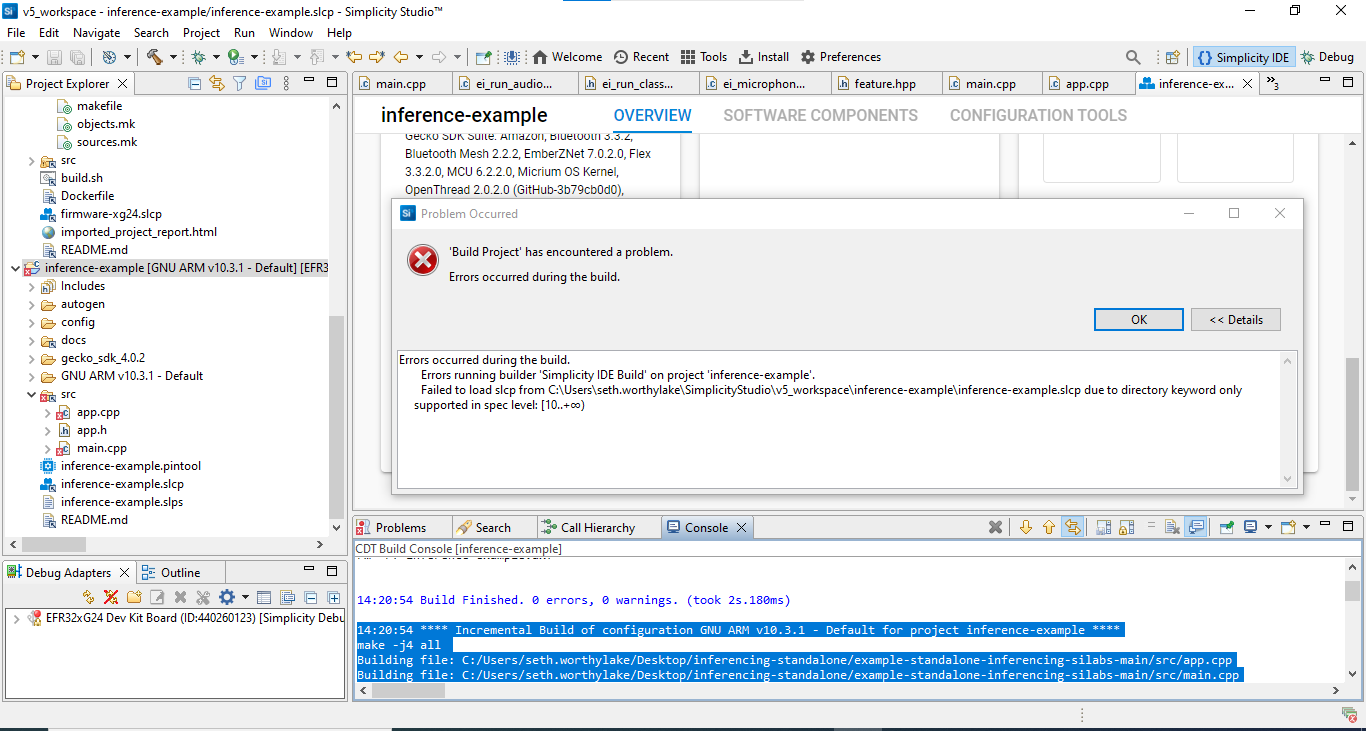

Hey @mateusz
I was able to figure out the issue.
So when I was importing the project something was happening with the slcp or slcc file and most of the project settings weren’t carrying over. Because of that I made sure to manually add the include path to the ei-model to both the C and C++ compilers in the project properties page.
This fix solved my issues regarding the compiler not being able to find the files in the ei-model directory.
