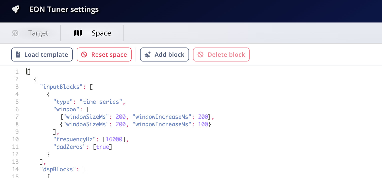

Have you changed the EON Tuner Search Space parameters? The window size parameter was set to 4000ms. As only your Unknown samples have duration longer than this value, it was the only class being classified.
I’ve changed it to the following values and it now goes through:
To answer your question, no because I either assumed the defaults were fine or didn’t notice the “Space” tab in the UI (it’s quite light gray). For window size being 4000ms, I mistakenly assumed it was the upper limit of inference time that I would accept and that it mostly didn’t matter. I’ll have to educate myself on this more now, thank you Aurel.
