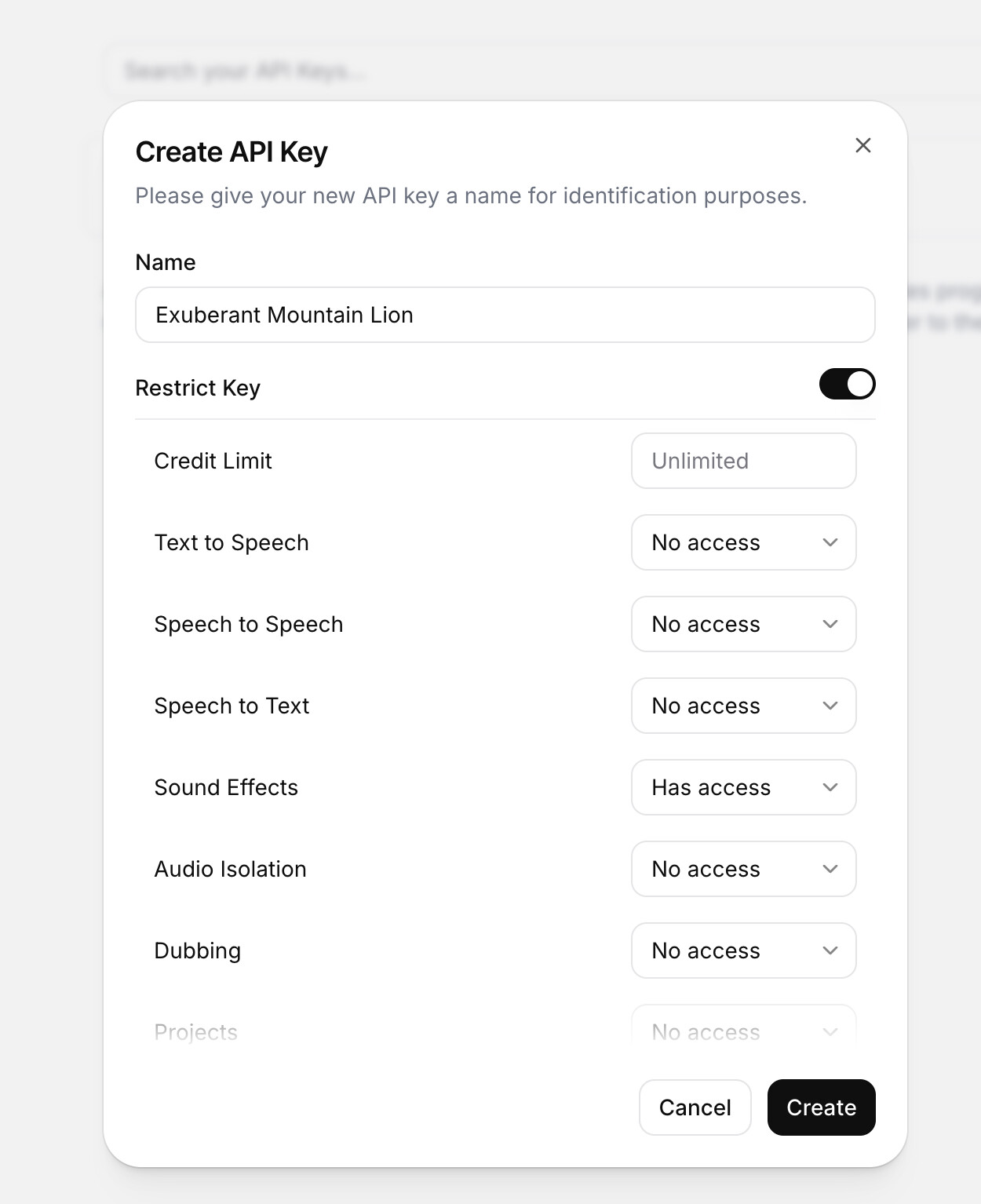

OK I have reproduced your error by first creating a key with the appropriate access:
  1. Create an API key, enable sound generation:

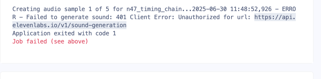

  1. Same error:

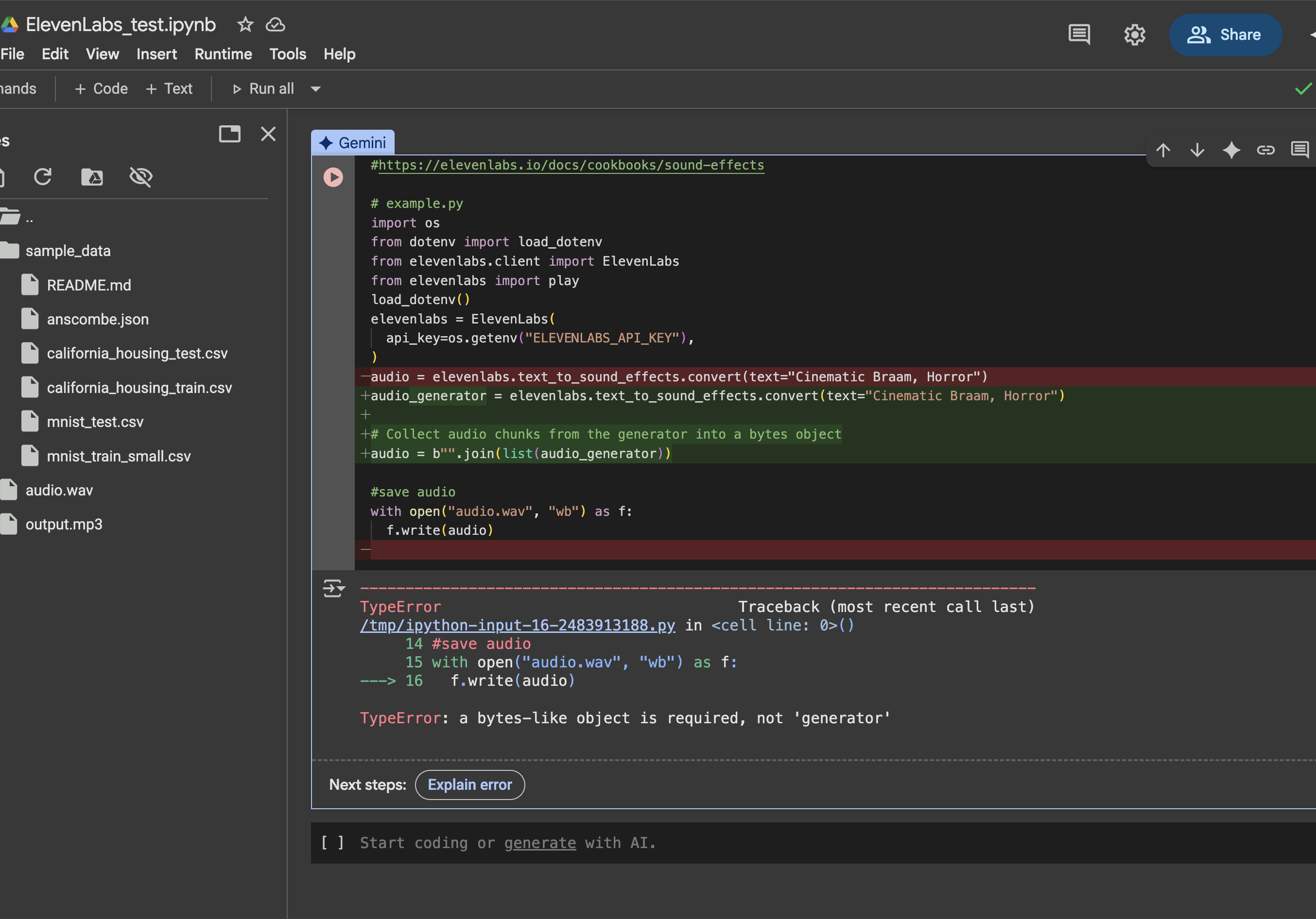

  2. I also validated this is also an issue when using the API key in a notebook, which leads me to believe this is on the elevenLabs side that the problem lies:
My suggestion is that you also log this with elevenLabs, I will try to do the same and see if anyone in our team can figure out what has changed in their API.
