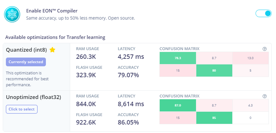

With relatively larger sizes, what is the main use case of .eim as an executable file? What are the differences between an eim executable and an optimized firmware(generated by EON compiler)? I found out that the following optimized firmware images can be generated.
Thanks in advance.
