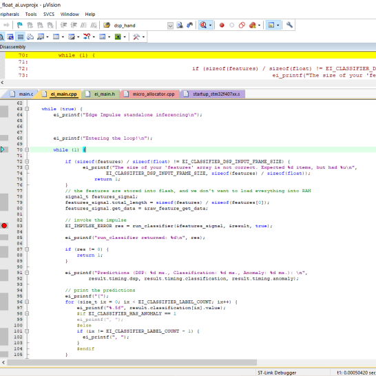

After importing the CMSIS pack exported from Edge Impulse into Keil, it can only run in debug mode. Moreover, After debugging and running to ‘EI_IMPULSE_ERROR res = run_classifier(&features_signal, &result, true);’
the serial port reports an error: ERR: Failed to run DSP process (-1002) run_classifier returned: -5

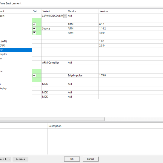

  • Build Environment Details: [
    keil MDK v5.43,
    ArmCompilerV6.24,
    CubeMx,
    CMSIS pack V6.2.0,(CORE V6.1.1)
    DSP 1.14.2,
    NN Lib 4.0.0]

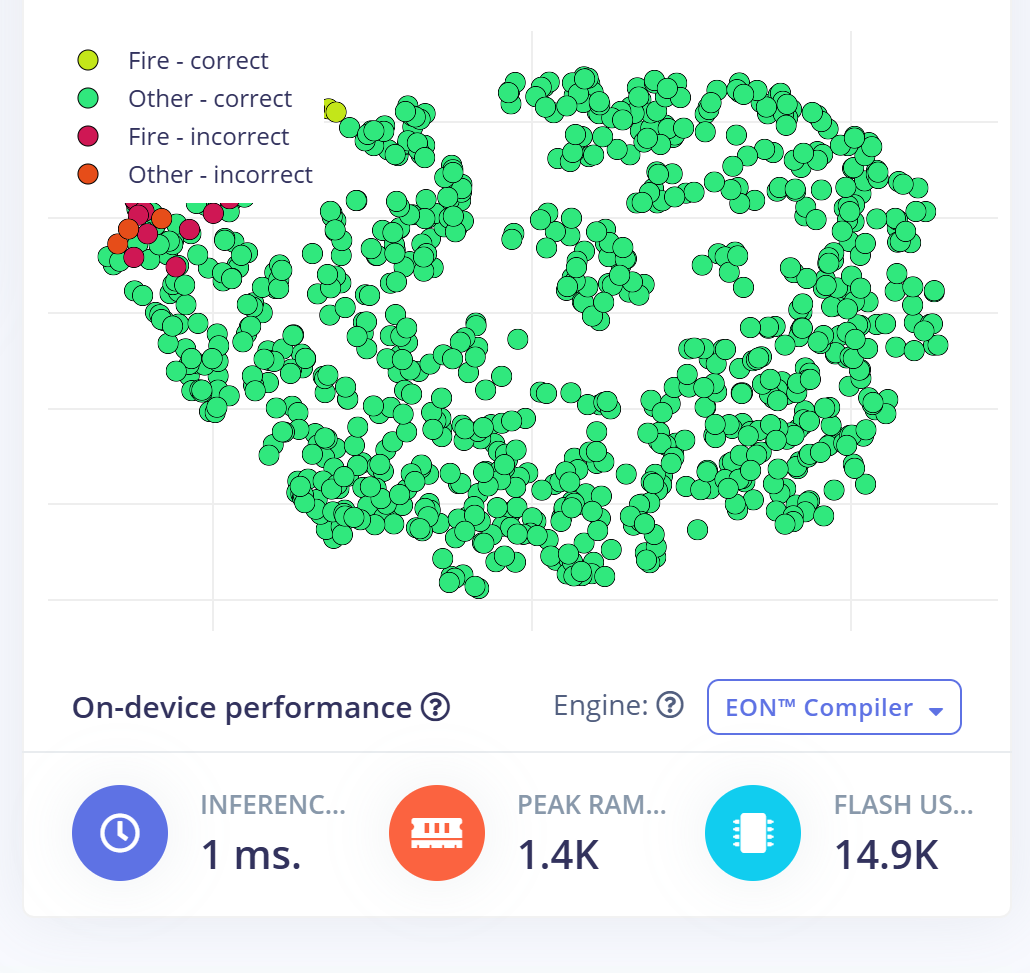

Thank you for the reminder. According to the error code, that’s correct, but the chart shows the RAM and ROM usage of my model. In reality, the STM32F407VET6 has much larger capacity than this.
