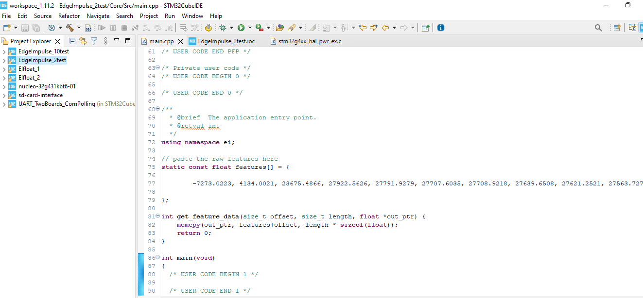

You have tested audio files from edge impulse studio and downloaded c++ library with same raw features. In my case i tested the same procedure with Cube.MX CMSIS-PACK instead of c++ library in embedded board STM32G474RE environment. But this gives me different result.
STM32G474RE raw features
STM32G474RE terminal result
