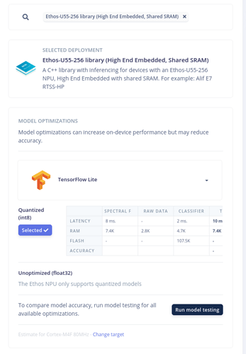

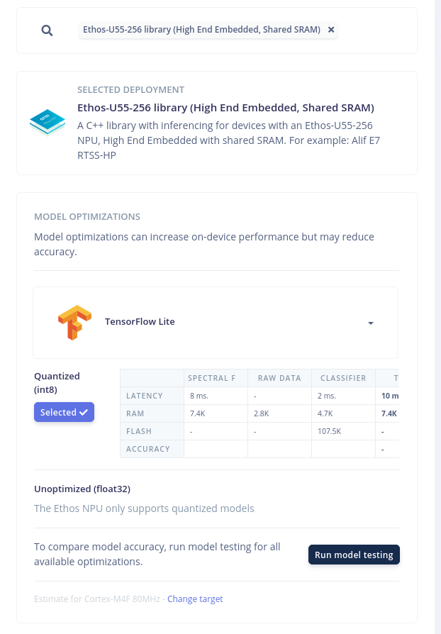

2. Exporting the model from Edge Impulse
I generated models using:
  • “Zephyr Library” → this always runs inference on the Cortex-M55, never on the NPU.
  • “Ethos-U55-256 library (High End Embedded, shared SRAM)” → this export includes its own Edge Impulse SDK and custom kernels.
But when I integrate this export into a Zephyr application, the build becomes very complicated, and I am not sure what is the correct and official way to integrate this NPU-enabled SDK into a Zephyr project.
