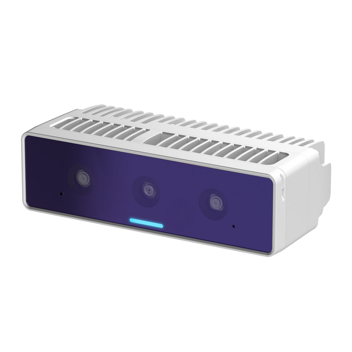

Maybe I will need to use a 3D camera and not use an edge device.
Could always hook up a stereo camera like the new OAK 4 D, I suspect you can connect and ingest directly to Edge Impulse, but fair warning, we haven’t tried! :slight_smile:
