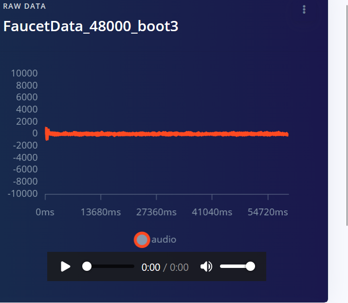

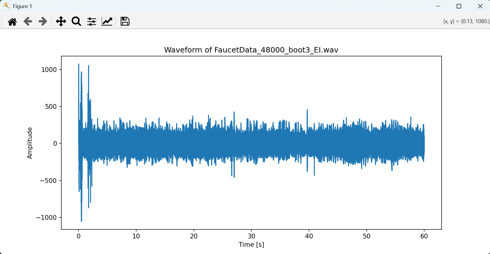

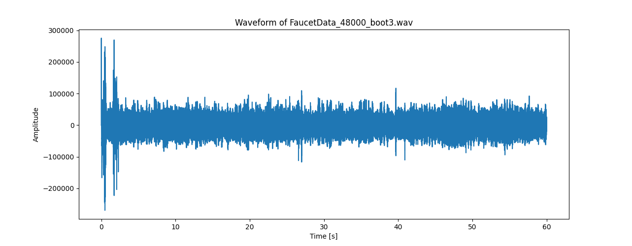

I know as a new forum user you were probably limited in the amount of photos you could post. Could you please share the two plots (the one shown in Studio and the one you have created yourself) for the same data sample. Let’s figure out what’s going on here.

Yes, it does appear that if you don’t upload a 16 bit wav (which is the typical precision), we’re rescaling it to 16 bit. The example you should tracks: the peak in the beginning of the frame is ~260,000. So 260,000 / 2^24 is about 0.15, so 0.15 max scale * 2^16 = ~1000, which you can see in the second graph
So if you have a true 24 bit input in deployment, and you can’t change that at the driver level, then just scale before calling run_classifier / get_data(). Scale like so: * 2^16/2^24. Or do the same thing with a bit shift (though the compiler almost always will see the optimization and do it for you in -O1 or better.

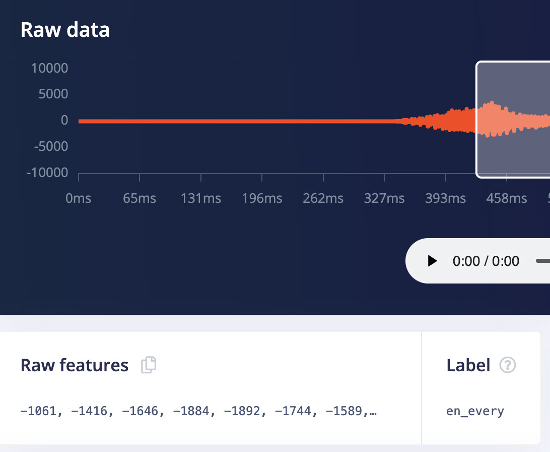

Another sanity check here: If you ever want to be sure how your data should look on device, take a look at “Raw Features” anywhere in Studio (ex: DSP screen, shown here)
