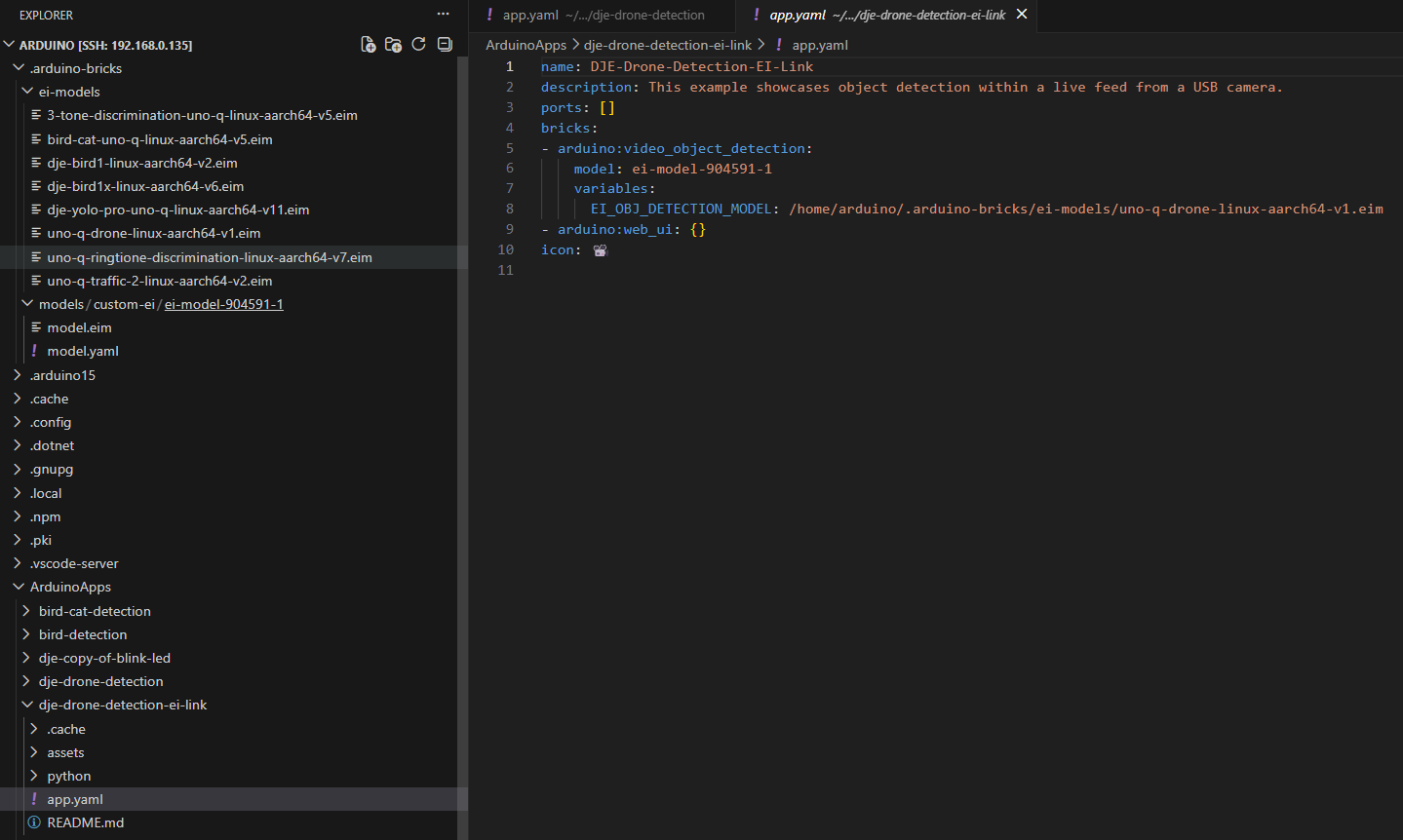

Here you can see where the newly cloned project still has the variable EI_OBJ_DETECTION_MODEL pointing to the .eim file, but now we have an extra argument at line-6, where we see model pointing to the newly downloaded .eim file, that’s stored in a new location /home/arduino/.arduino-bricks/models/custom-ei/ei-model-904591-1
So it all works with the new flow, but the classic flow would be good to fix.

From your screenshots and description, it looks like App Lab 0.5.0 may now be using the new model parameter for the video object detection brick, and that this takes precedence over the older EI_OBJ_DETECTION_MODEL variable.
That would explain why the linked/downloaded models work from /home/arduino/.arduino-bricks/models/custom-ei/..., while the classic manually referenced .eim files under /home/arduino/.arduino-bricks/ei-models/... are ignored.
So this seems less like a model issue and more like either a backward-compatibility regression or a change in expected configuration in App Lab 0.5.0. Agreed that it would be good to either restore the classic flow or document that the new model field is now the supported path.
