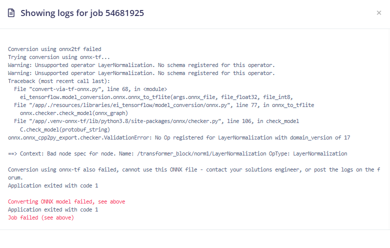

When trying to deploy our customized quantized int8 model (onnx format) using the Edge Impulse, the page would report a series of errors. However, when we deploy the pruned fp32 model (onnx format), it works fine.

  1. Upload the int8.onnx file through the “Upload your model” tab
  2. After uploading, let Edge Impulse start processing job

Actual Results:
A series of error report

Hello @minghao8926,
Thanks for sharing the logs, I’ll see with the core engineering team if LayerNormalization operation could be added to the supported operation.
In the meantime, you can still quantize (post-training quantization) your model by adding enough representative features. This easiest way to do this is through our Python SDK:
Let me know if you encounter any issues.
