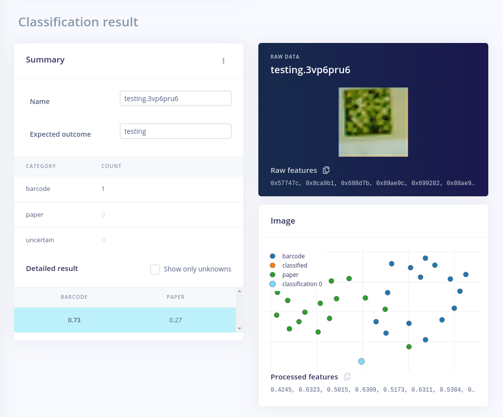

but the model downloaded seems to be not what I trained … it was classifying most of the image features as face(1.0)
          oK. I reflashed again with the firmware.uf2, this time, no more face but not able to classify either paper or barcode. In the Live Classification, the model was at least able to ID …
What’s up? Sorry … steep learning curve here …
          It looks like the Impulse is confused. By that I mean on the left side there is:
barcode,
paper, and
uncertain.
And on the right side:
barcode
paper
classified ← What is this?
classification 0 ← What is this?
Look thru all your data and check the Labels to make sure you only have barcode, paper, and uncertain. Then retrain and re-deploy.
