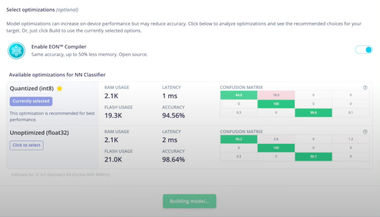

I noticed that in the Deployment tab of the last version of EIS the confusion matrices of the quantized and unoptimized models of the impulse are no longer available. While the confusion matrix of the unoptimized model can be retrieved in the Model testing tab, how can I get the one related to the quantized model?

If I’m not wrong, in the older versions of EIS, within the Deployment tab, confusion matrices related to the models (i.e., quantized and float32) performances on the test set were shown.

You’re correct, sorry for that, I found an old video I recorded and it does show a confusion matrix overview.
