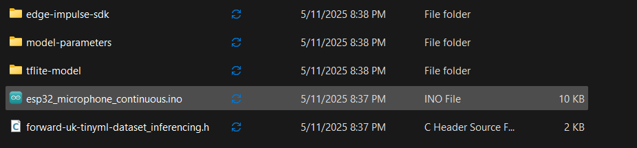

my working directory:
Hi @Vir_qui_sensum_quaer
Ah wait did you first:
  • Sketch > Include Library > Add .ZIP Library
Maybe you missed that step
@ei_francesco what do you think?
