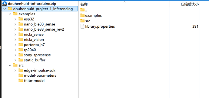

Compile error for ESP32
Compile error when compile inference script with model
xtensa-esp-elf-g++.exe: fatal error: cannot execute
'C:/Users/DOUBUHUI/AppData/Local/Arduino15/packages/esp32/tools/esp-x32/2507/bin/../libexec/gcc/xtensa-esp-elf/14.2.0/cc1plus.exe'
: CreateProcess: No such file or directory
822852
use code below
