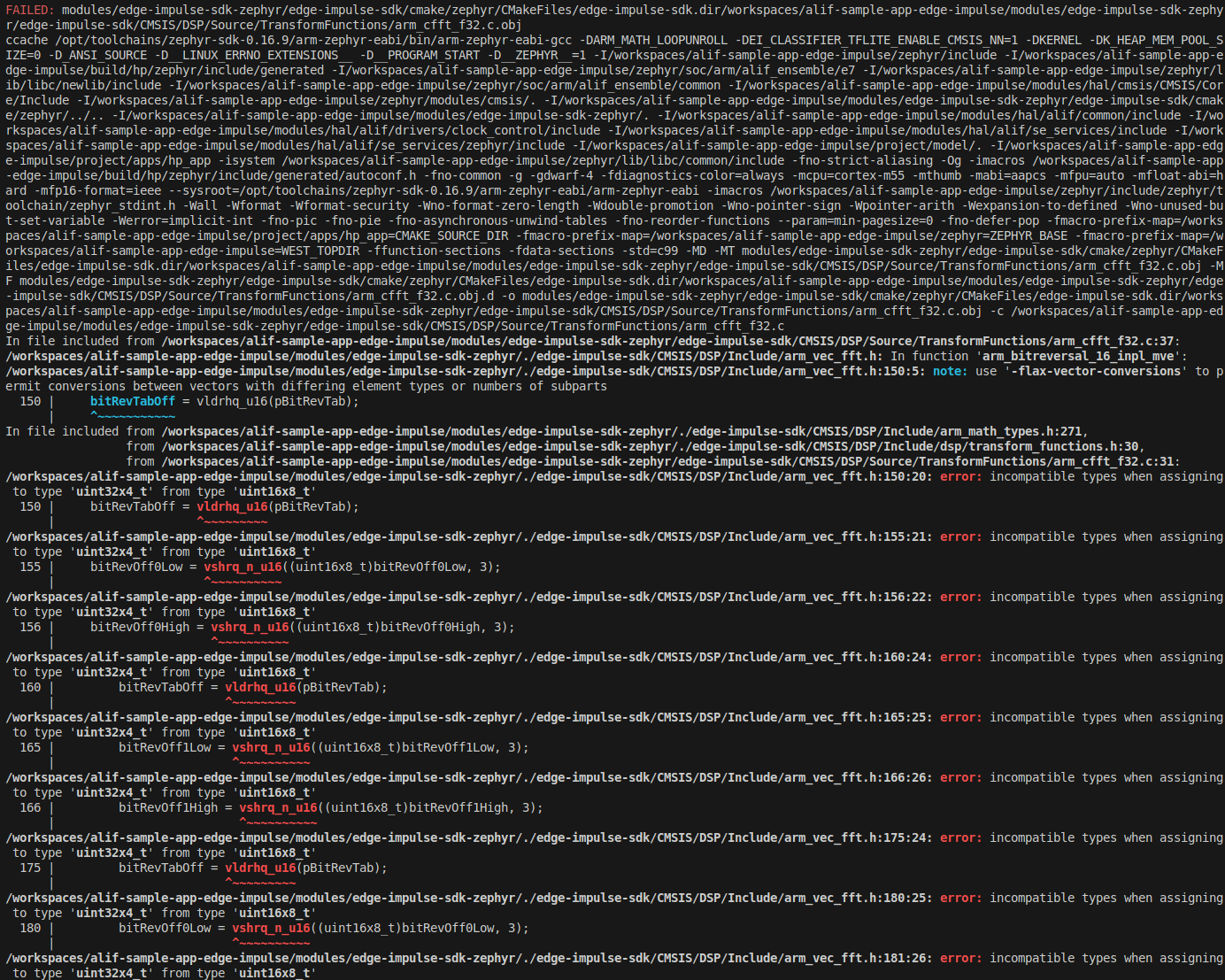

During the build, I consistently get the following compilation error:
Does anyone know where this error comes from and how I can fix it?
Hi @Rizelaine
as the error suggest, you need to add -flax-vector-conversions to the compilation flag,
ie
zephyr_library_compile_options(-flax-vector-conversions)
To the CMakeList file
Thank you, it worked !!
