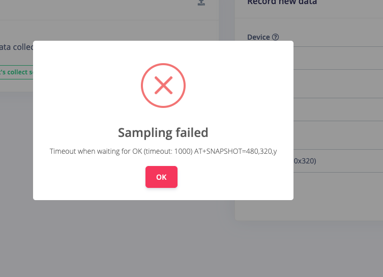

I encountered below issue with the ESP32 based M5stack(m5-docs).I can not manage to see a camera feed.

Hello @shakhizat,
Which camera are you using?
Did you change the camera header when recompiling the default firmware?
Hi @louis,
Thanks for you reply.
I am using ESP32 Camera Module Development Board (OV2640) by M5stack.
Yeap, I did it by commenting out #define CAMERA_MODEL_ESP_EYE line in the ei_camera.h file, then adding #define CAMERA_MODEL_M5STACK_ESP32CAM, and finally recompiled and flashed it.
So, according to the link I found here
the example code for this camera module is
and I see they have the following define
#define CAMERA_MODEL_AI_THINKER // Has PSRAM
I cannot confirm if it is correct, since I do not have the board. But following the docs and examples for the board is the way to go here.
