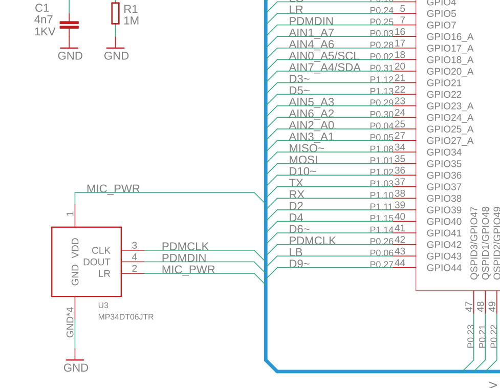

    the microphone on board is MP34DT05, you can find breakout board for it and then connect it to the Arduino nano 33 ble pins. Since onboard microphone pins are not available on board headers you will need to change them in code and compile locally.
you will need to change the microphone code to include the external one. If you want to be able to do in the same way as the sense board, and do not want to solder ti, then change files as suggested here:
