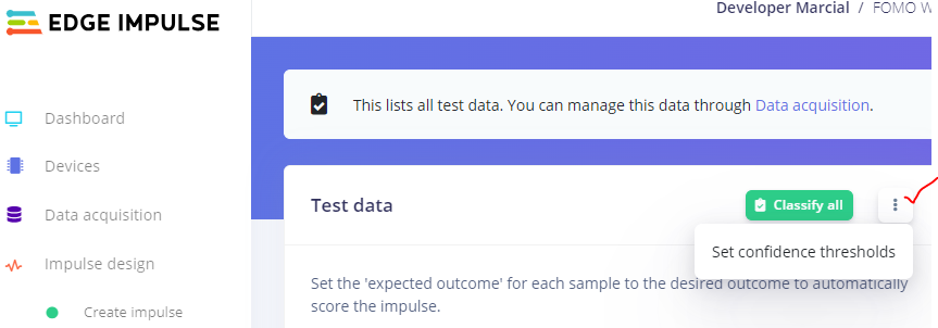

Also, is it possible to change the value for probability so that only items with confidence >80 percent show just using the Edge Impulse web based platform?
