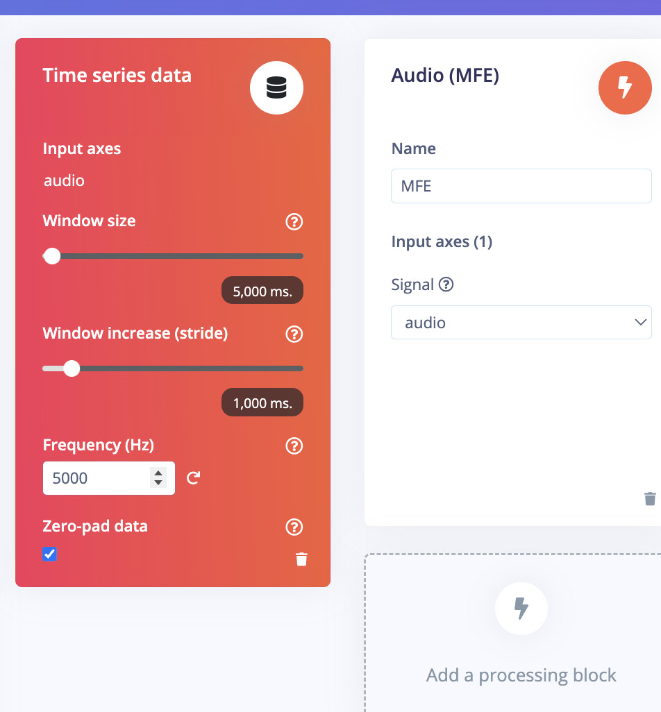

With the 5kHz, I was able to get 95% accuracy in the model testing, But the real time classification was way out. I think my code was not handling the buffer correctly.

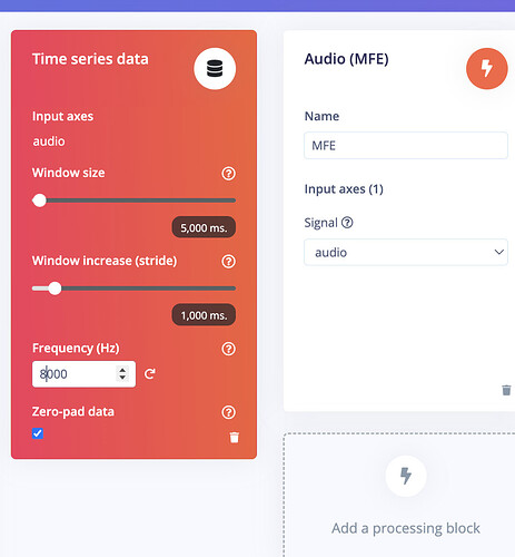

Hi @se732525
Can you share the DSP configuration from the Signal Window page and your create impulse page?
Downsample Training Data
  • Train your model on 5kHz or 8kHz downsampled versions of your data (match what the ESP32 can actually capture.)
  • This helps the model learn in the same spectral context the device will use.
e.g.
Did you record a sample with the ESP 32 mic to confirm the WAV is collected as expected?? Try capturing a sample raw to test with.
Improve DSP Configuration
  • Use MFE or MFCC, not both because the memory is not sufficient.
  • MFCC config to try:
    • Frame length: 0.02
    • Frame stride: 0.01
    • FFT length: 512
    • Number of coefficients: 13
    • Filter count: 32
    • Low freq: 300, High freq: 3800
    • Pre-emphasis: 0.95
