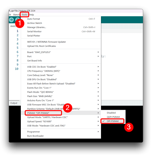

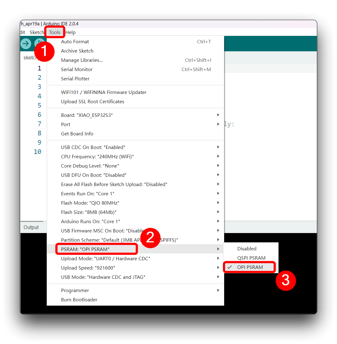

Hi @Hellesse
Have you enabled the PSRAM? I am not sure about this devkits limitations but typically this is a common missed step.
