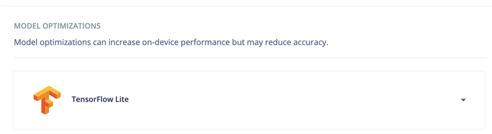

  • use non-EON model
  • modify the kTensorArenaSize and /or EI_MAX_OVERFLOW_BUFFER_COUNT in tflite-model/tflite_learn_**_compiled.cpp. You MUST modify it in that model file, simply adding defines to main.cpp or Arduino sketch will not work. The exact number would require some trial and error / guesswork.
